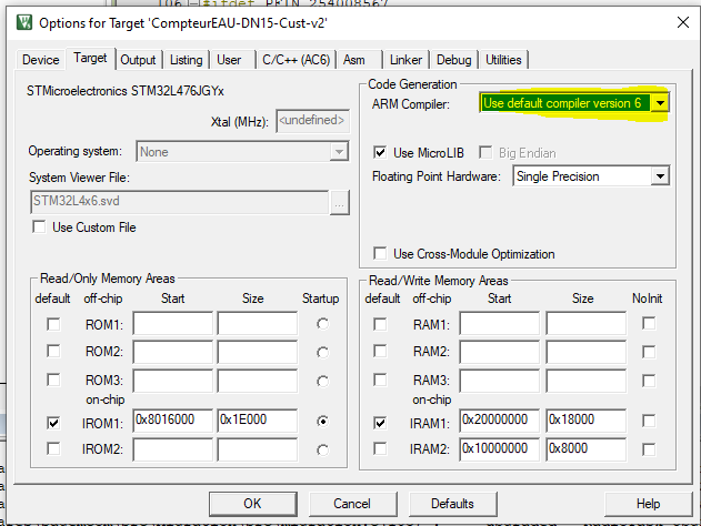

Hello Ronan,
thanks for your response.
You are right, after I changed the compiler version to 6, the event record works fine.
