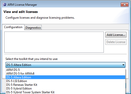

In the mean time, have you tried to license DS-5 through the license manager? I notice that in your diagnostic info it says "Selected toolkit: none", so it might be worth double checking that you have selected the right version from the dropdown list in the DS-5 license manager.

Hi,I don't have an option for selecting a toolkit. Does that mean I probably haven't downloaded the right version of the DS-5?Regards,

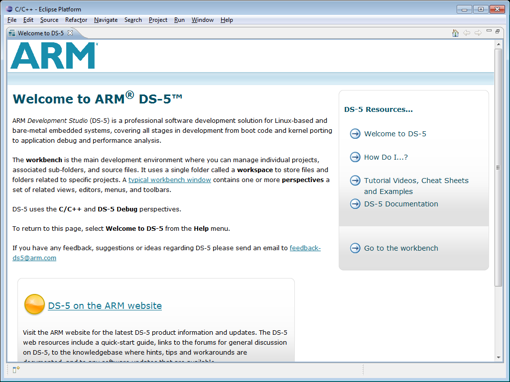

OK, I've just downloaded and installed the same package from the Altera website. The first time I opened it, it brought up a vanilla version of Eclipse which was odd, but it's working fine for me now. Once you start DS-5, you should see a welcome screen that looks like this:

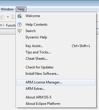

If this is the case, then you should be able to get to the license manager through the help menu. If you don't see this then let me know.
By the way, thanks for your help so far. I get a slightly different splash screen:

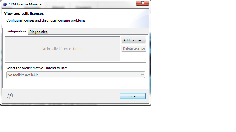

and when I pull up the license manager I get:
I don't seem to be able to select a toolkit.

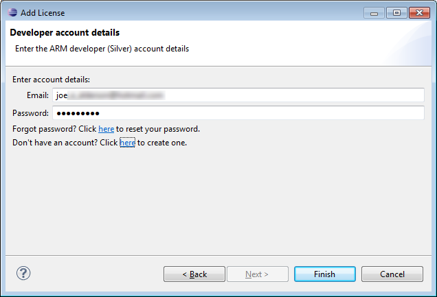

I've deleted my licenses to replicate what you have there. I then created a new account to test the system out - it seems to be working OK (once you've created the account it autopopulates the email and password fields):
You might want to test your login details on arm.com (login at the top right), bearing in mind that you have to activate your account if you have just set it up by following the link that will have been automatically sent to whatever email address you used.
If you're still having trouble, try setting up a new account with a different email address by following the "Don't have an account?" link in the license manager.
