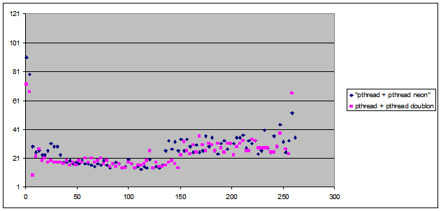

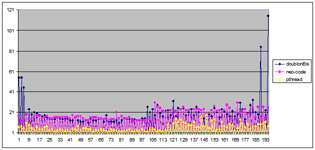

  • here is the last test.
    I run both function inside the pthread this time.
    Both doublon and neon functions take nrealy the same time. In yelow is the pthread time running alone. The pthread is much more complicated and it is faster.
    Is there a limit to phtread instructions ? I will try both doublon and neon functions inside pthread. Let see.
    So doublon or neon inside other pthread run faster than 1 pthread + 1 pthread with doublon or neon.

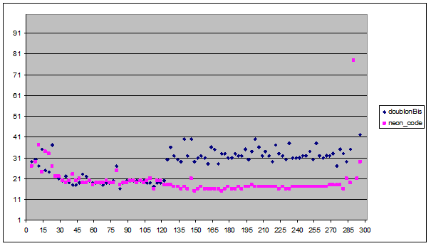

    My conclusion would be to use compilator. The first picure a send in the prévious post is when i run 4 time the doublon and 4 time the neon. Dans in this case neon is faster but both are slower than function inside other pthread or function inside pthread.
