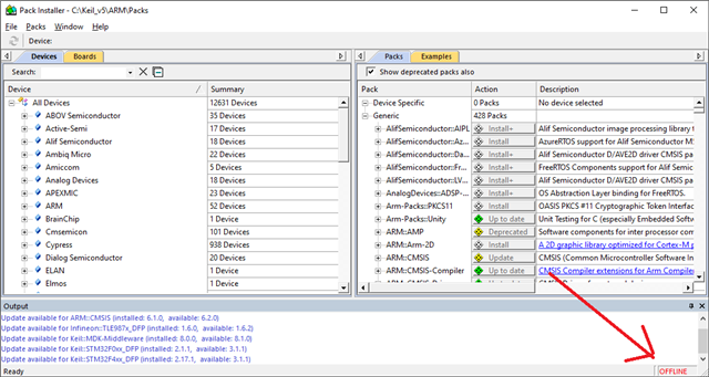

We are having a network problem with the pack installer. When using company wifi we see "OFFLINE" error. If I connect my laptop to my hotspot internet I do not have any problem. I can ask our IT to give access to certain servers(address's). Which address's should we give access to?

Hello Hans,I was having the error you mentioned>cpackget.exe connectionI: Using path: "">https://www.keil.com/pack"E: "">https://www.keil.com/pack": remote server is offline or cannot be reachedAfter this our IT gave permission to "keil.com" and "keil.arm.com" on the firewall. It seems that our firewall was blocking it. I do not see any error when I run "cpackget.exe connection".But I still see "OFFLINE" error on the pack installer.What other permission should we give or which settings should we do?
