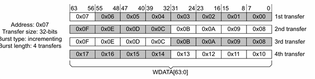

Please consider following example:
CASE 1)
Data bus width = 32 bit
awsize = 1
awlen = 3
Address = 0x03
burst type = FIXED.
CASE 2)
awsize = 1
awlen = 3
Address = 0x03
burst type = INCR.
are these invalid transfer or AXI will handle this?
