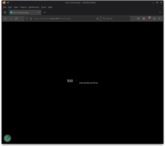

Don't know where to report technical issues according the ARM homepage,
so I try it here.
When I want to open the link https://developer.arm.com/community I always
get the error 'Internal Server error 500' with Firefox 128.10.0 ESR
(with uBlock Origin) running on Debian 12. I can use all other sites on
ARM without issues, only not main site in the link.
As workaround I have disabled uBlock Origin, which has fixed the
issue. It's might not an technical issue from ARM itself, but still
wondering why all other sites on ARM works with enabled uBlock
Origin.
Should I report this to the developers from uBlock Origin too?
EDIT: Add screenshot; Fix formatting
For uBlock Origin I have created a report, but was rejected with not planned and site-issue.
https://github.com/uBlockOrigin/uAssets/issues/28310

Hi Oliver!
For further investigation:
uBlock Origin blocks some required JavaScripts on external domains:
assets.adobedtm.com
munchkin.marketo.net
A quick fix is to allow/whitelist those domains in uBlock Origin:
@@||assets.adobedtm.com @@||munchkin.marketo.net
Under settings->My filters. Hope this helps for other users.
This is very useful, thanks for sharing this with the community :)
I have an update about my opened but rejected issue ticket for uBlock Origin. It was reopened by the original author from uBlock Origin. So it will be fixed by the uBlock Origin developers. :)
(My solution was quick and dirty)
