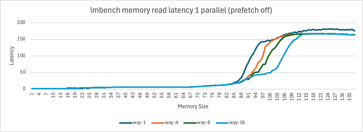

Advance verification
To verify that the SLC partitioning is works correctly, use the lat_mem_rd memory latency benchmark from lmbench.This tool measures read latency while gradually increasing the working set size.
In theory, read latency should spike when the working set exceeds the SLC capacity. At that point, data must be fetched from main memory. By setting different SLC cache partitions, you can observe distinct latency curves. Smaller allocations cause the latency increase to occur earlier. Be cautious, the CMC prefetch would influence the lat_mem_rd, so disable it before testing.
Our test results confirm this behavior. The one-way SLC allocation showed an earlier latency jump. The 16-way allocation maintained low latency until much larger working set sizes.
 MPAM lmbench memory read latency for different l3 partition

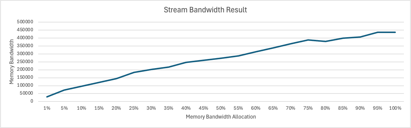

Advance Verification
To simulate a noisy neighbor scenario, we run both a measurement workload and a competing workload:
  • STREAM is used as the measurement tool.
  • stress-ng acts as the noisy neighbor.
We split the CPU cores of NUMA node 0 into two equal groups, each assigned to a separate resctrl group. STREAM is bound to the first group, stress-ng to the second.
We then dynamically adjust the memory bandwidth allocations. Increasing bandwidth for the first group while decreasing it for the second. The STREAM results change accordingly, showing that MPAM enforces bandwidth isolation between workloads.
 MPAM memory bandwidth partition
