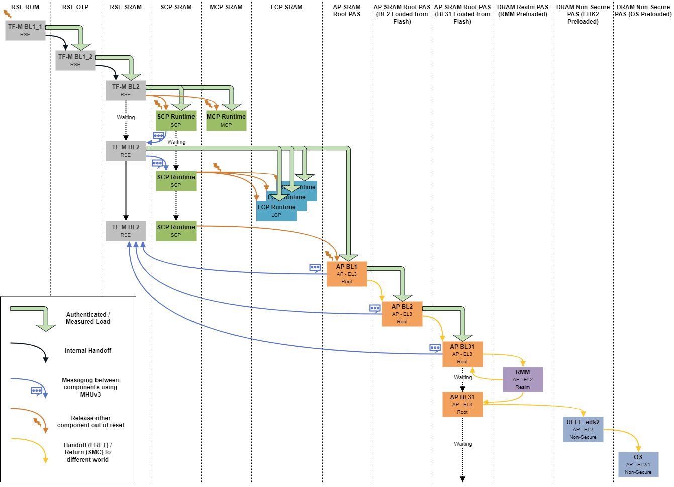

RD-V3 Single Chip Boot Flow
RD-V3 single chip boot flow

Developers can simulate and inspect every stage of the boot flow, from the Runtime Security Engine (RSE) to the Application Processors (APs). The platform supports TF-A, UEFI, GRUB, and Linux kernel components. This helps developers understand initialization sequencing and cross-component interaction.

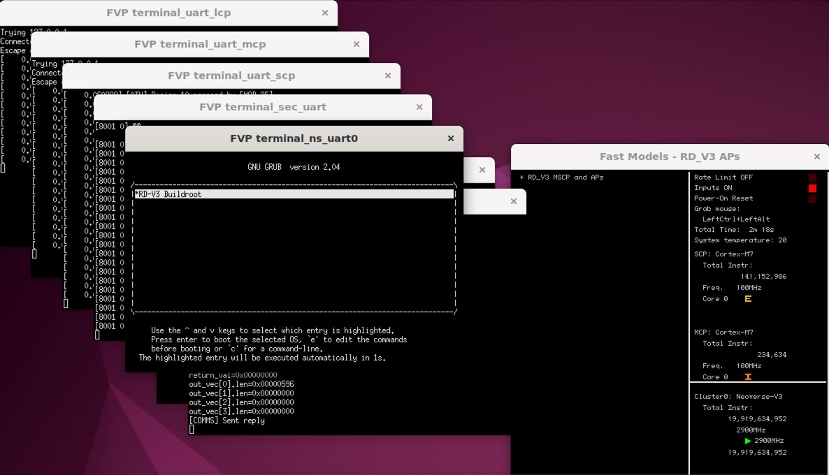

RD V3 simulation run
During simulation with the RD-V3 Fixed Virtual Platform (FVP), developers interact with several UART terminals. Each terminal is connected to a specific CPU subsystem. The terminals provide direct visibility into firmware and system behavior across secure and non-secure domains.
Terminal window title
UART
Output role
Connected processor
FVP terminal_ns_uart0
0
Linux Kernel Console (BusyBox)
Neoverse-V3 (AP)
FVP terminal_ns_uart1
1
TF-A / UEFI Logs
Neoverse-V3 (AP)
FVP terminal_uart_scp
2
SCP Firmware Logs (power, clocks)
Cortex-M7 (SCP)
FVP terminal_rse_uart
3
RSE Secure Boot Logs
Cortex-M55 (RSE)
FVP terminal_uart_mcp
4
MCP Logs (management, telemetry)
Cortex-M7 (MCP)
FVP terminal_uart_lcp
5
LCP Logs (per-core power control)
Cortex-M55 (LCP)
FVP terminal_sec_uart
6
Secure World / TF-M Logs
Cortex-M55
This simulation makes it easier to:
  • Trace early boot stages (e.g., RSE and SCP) without interference from later system logs.
  • Debug secure vs non-secure domain transitions.
  • Validate that each subsystem performs its intended initialization.
