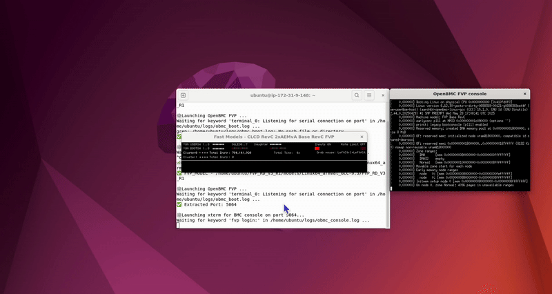

The following animation shows a time-lapsed view of the entire simulation process:
  • The right window shows OpenBMC firmware booting to a Linux shell.
  • The left window shows the host-side SoC booting following the CSS-V3 boot sequence: TF-A → SCP → UEFI.
  • When both systems are running, they communicate through UART and IPMI in a bridged simulation.

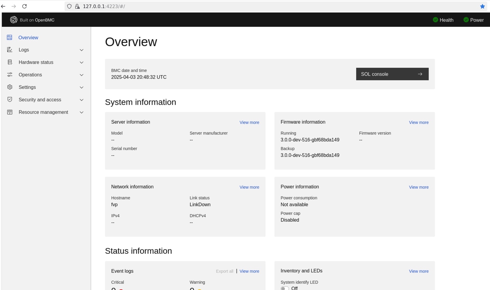

The virtual BMC runs the full OpenBMC userspace. It allows you to start real BMC services like Redfish or Web UI servers, and interact with them through standard interfaces during simulation. This enables you to prototype, test, and even automate BMC features without using hardware.
UI overview of OpenBMC interface
