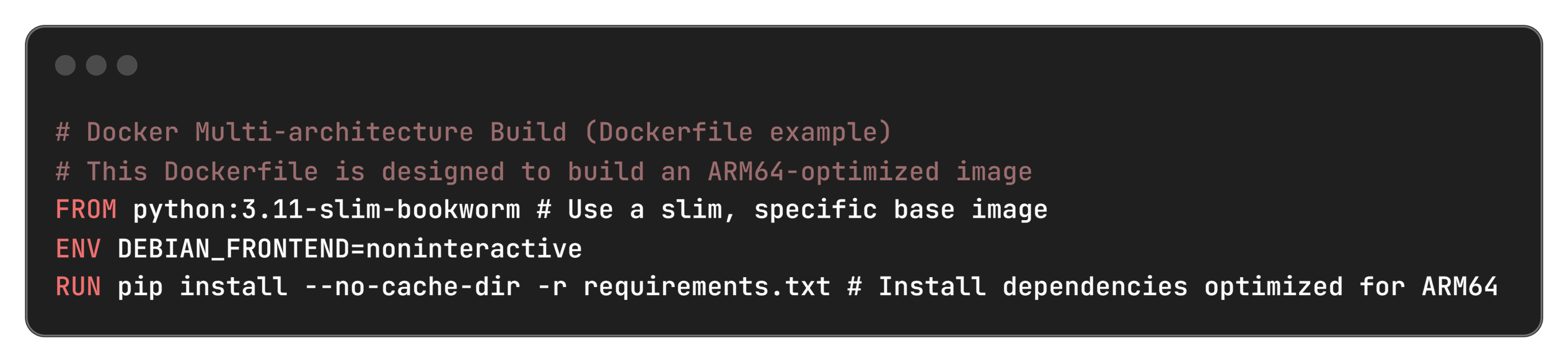

Docker file:
Docker file

2. Cross-platform builds
  • Solved with Docker Buildx to simplify multi-arch compilation.
Docker BuildX
