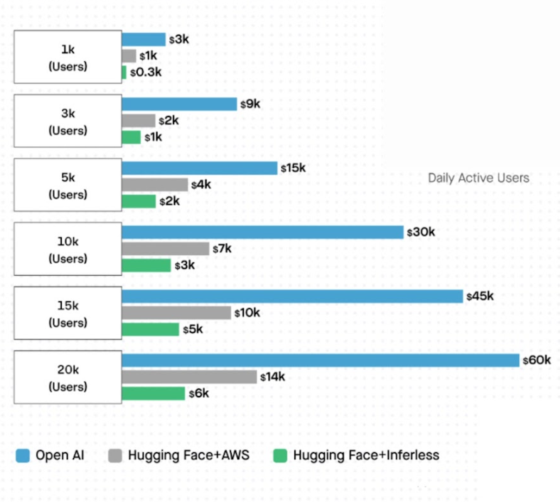

Daily active users across OpenAI and Hugging Face
