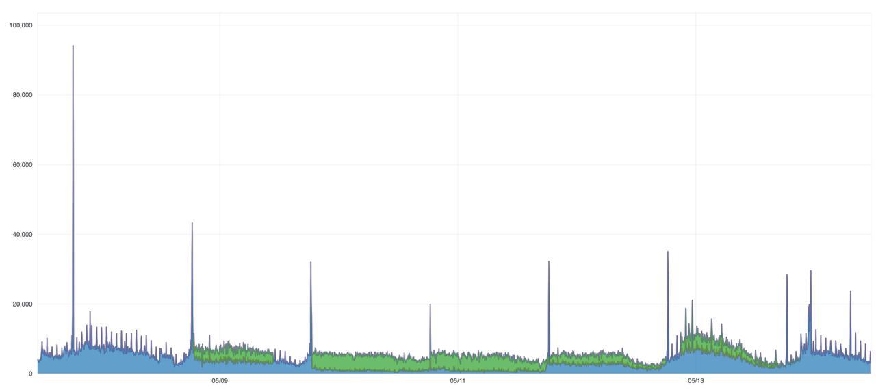

When SiteMana onboarded a large new publisher, our infrastructure load increased exponentially overnight. Each visitor page view flowed directly into our real-time ingestion pipeline. This rapid traffic caused CPU credits to quickly exhaust on our AWS x86-based t3.medium instances. As a result, performance was throttled at the exact moment we needed stability most. We quickly realized our system was not just scaling, it was breaking.
Server requests overview: green represents 400x requests, blue represents 200x.

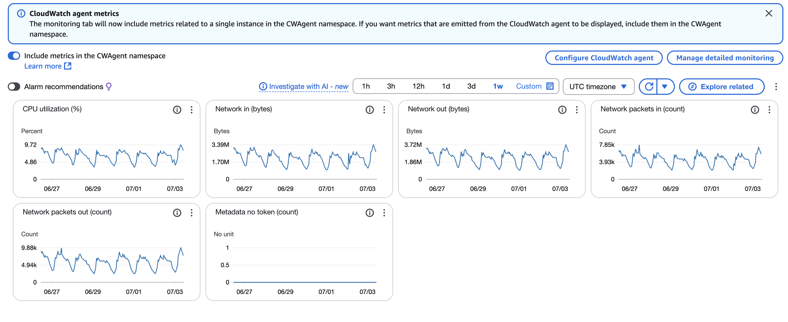

This shows the impact of our migration, especially around throttling issues.

Impact: Immediate and measurable results
After migration, SiteMana experienced significant operational improvements:
  • Eliminate CPU credit throttling.
  • Increase per-instance network bandwidth from 5 Gbps to 12.5 Gbps (2.5x improvement).
  • Reduce TensorFlow inference latency by 15%.
  • Reduce monthly infrastructure costs by around 25%.
  • Consolidate workloads into a simpler, more manageable architecture.
You will see a significant improvement in stability after we transitioned to Arm architecture.
