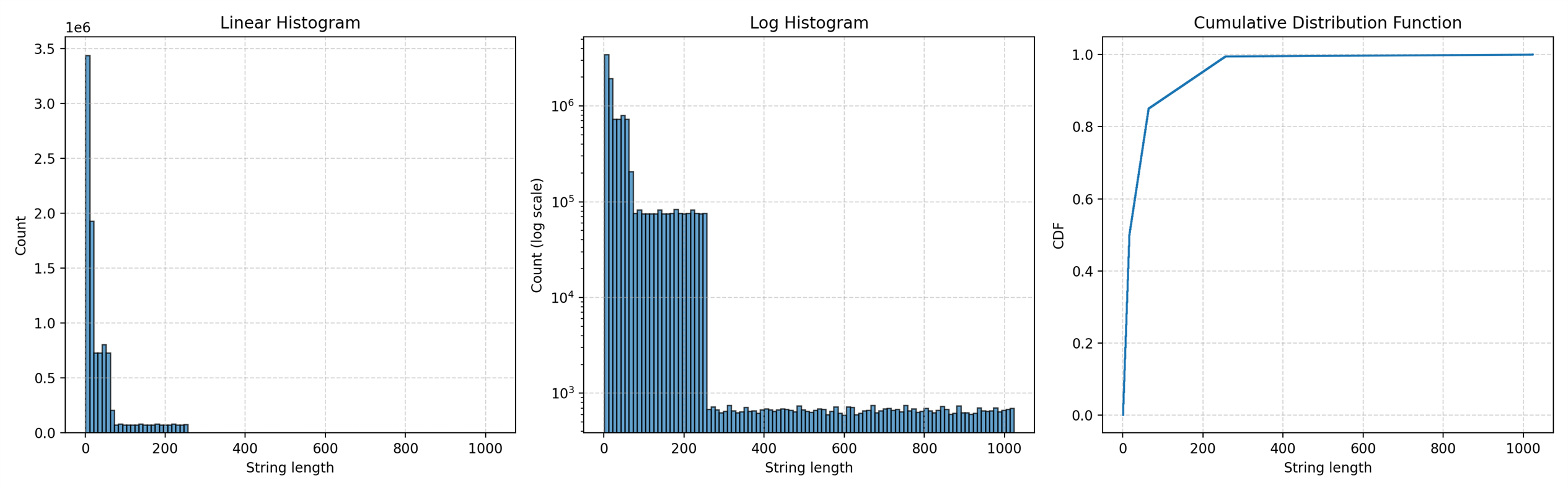

Input key generation
To better reflect real-world usage scenarios ,where hash functions are typically applied to relatively short keys, we created a dataset of 10 million keys. Key lengths ranged from 1 to 1024 bytes. In practice, keys used in hash functions tend to be small. We designed the key length distribution to closely mimic realistic workloads.
This dataset serves as the foundation for our performance benchmarks. It helps us evaluate how different hashing strategies behave under practical conditions. You can see the distribution of key lengths in the figure below. If you are curious about the key generation algorithm, feel free to reach out. I am happy to share the details.
Input key distribution

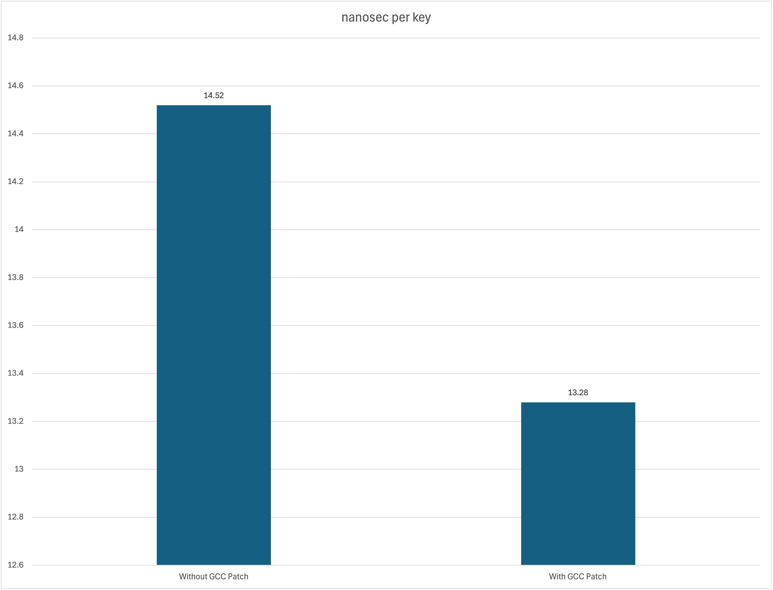

The time to compute a single key hash, measured in nanoseconds per key, dropped from 14.52 to 13.28 after the optimization. These represents about a 9% performance improvement. Graph showing the time to compute the hash of single key, from 14,52 nanoseconds per key to 13.28, representing a 9% performance improvement.

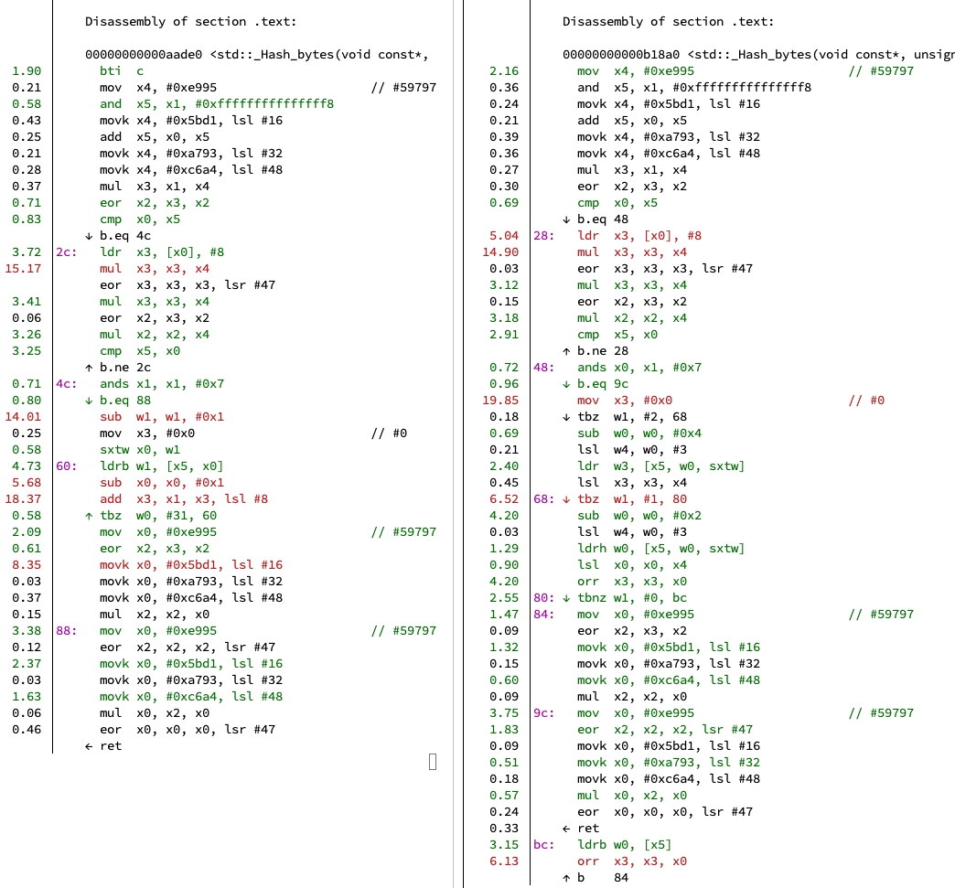

Perf assembly
We can also check what is changed in assembly code by using perf record/report command.
perf record -g  ./perf_stdlib 10000000 --input ~/blog/key.urls --hasher murmurhash2_64
perf report -i perf.data
The left side shows the assembly code before optimization, while the right side shows the assembly code after optimization.
 Diagram showing the comparison between left side shows the assembly code before optimization, while the right side shows the assembly code after optimization.
The left-hand side shows a loop that loads one byte from memory per iteration. Whereas the right-hand side uses ldr, ldrh, and ldrb instructions to load 4, 2, and 1 bytes of data respectively.
