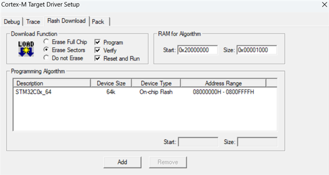

Just to clarify, when you say it's configured to flash from 0x08003000, do you mean you've changed the linker start address, or the Flash Download address range in uVision? Have you ever tried modifying the address range under Programming Algorithm by selecting your flash algorithm 'STM32C0x_64' and changing the 'Start' address to 0x08003000?Reference: developer.arm.com/.../Target-Driver-Settings

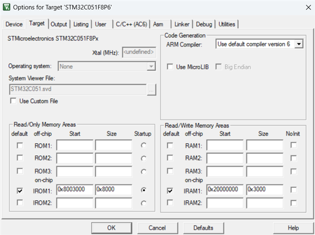

I updated the IROM1 setting in uVision Options > Target from 0x08000000 to 0x08003000. This successfully flashes the application from 0x08003000, but during flashing, page 0 still gets erased. However, pages 1, 2, and 3 remain intact. Additionally, the scatter file or the linker file is generated:; *************************************************************; *** Scatter-Loading Description File generated by uVision ***; *************************************************************LR_IROM1 0x08003000 0x00008000 { ; load region size_region ER_IROM1 0x08003000 0x00008000 { ; load address = execution address *.o (RESET, +First) *(InRoot$$Sections) .ANY (+RO) .ANY (+XO) } RW_IRAM1 0x20000000 0x00003000 { ; RW data .ANY (+RW +ZI) }}I tried modifying the address range under Programming Algorithm fromstart=0x08000000, size=0x00010000 tostart=0x08003000, size=0x0000D000But it still erases page 0.But I also get this when I change the address range under Programming Algorithm:No Algorithm found for: 08002000H - 0800202FHNo Algorithm found for: 08002800H - 0800282FHPartial Erase Done (areas with no algorithms skipped!)No Algorithm found for: 08002000H - 0800202FHNo Algorithm found for: 08002800H - 0800282FHPartial Programming Done (areas with no algorithms skipped!)Partial Verify OK (areas with no algorithms skipped!)Application running ...
0x08000000
0x08003000
*.o (RESET, +First)
*(InRoot$$Sections)
.ANY (+RO)
.ANY (+XO)
.ANY (+RW +ZI)
