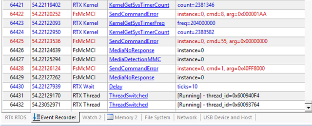

Calls to fmount() randomly results in hardfaults. Using the EventRecorder, a few rather obtuse errors are logged shortly before the hardfault (see below)
The hardfault happens right upon return from a call to osDelay() from within fmount() (the RTX Wait event listed near the end of the event list in the attached capture).

Do you have the CPU state at Hard Fault time? e.g. the 8 stacked regs which include the PC and LR.
