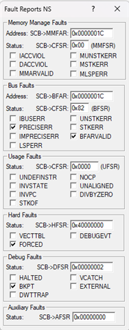

  • I would suggest you debug that function and see when and if it is the one that causes that fault.
    From your information it looks like the CPU tried to access memory at address 0x1C (BFAR register) and it seems there is no memory mapped at that address thus it resulted in Bus fault.
    And then the BusFault handler caused another fault resulting in HardFault escalation.
    You can take also a look at CMSIS-View Fault analysis and use that to try to find what exactly happens.

  • Hi Milorad
    The problem was, that the SysTick Timer was configured instead of TIM6. So the SysTick was running and if the initalisation process needs more time the RTX tries to start a thread but the OS isn't configured because I start it after the hardware initalisation and directly after enable of TIM6 (that wasn't my SysTick timer).
    Inside the osRtxTick_Handler there is no control if there is allready a task or not.
    Thanks and kind regards
    René
