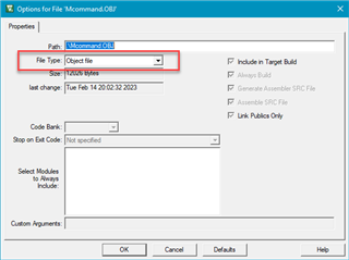

That's easy. Just add your *.obj files to your project (right click the group in the project window and select 'Add Existing File to Group ...'). The file type 'OBJ File' should be selected automatically. If not, right click to the *.obj file in the project window and select 'Options for File …' and select the File Type 'Object file':
Then, this file will be just linked to your project.
