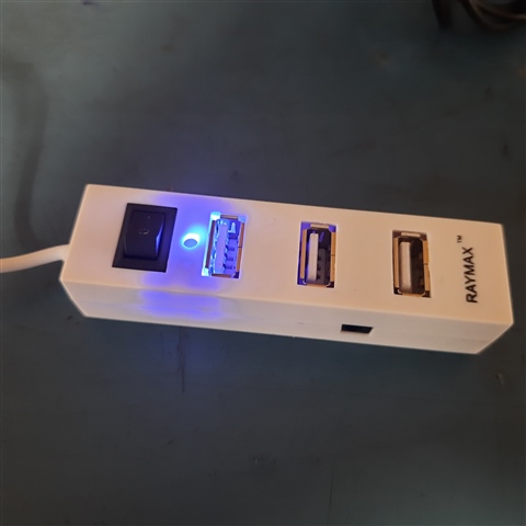

When i connect usb hub, it gets detected
When i connect flash drive into one of the usb-hub port, it is working
But When i connect keyboard into one of the usb-hub port, it is not working

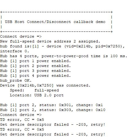

But in my sample code, i am having so many functions for hubs and they are used and my hub is also working
but when i connect keyboard into usb hub it is not working

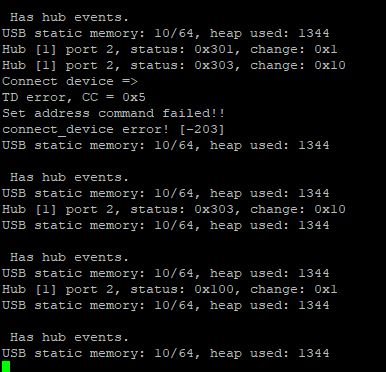

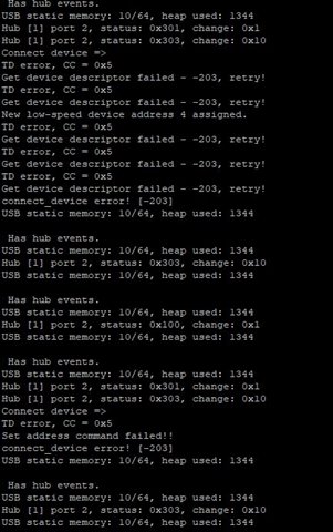

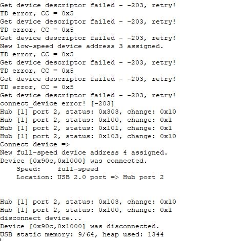

I am attaching my error details with my devices for your reference

You should start by understanding why you get TD Error, it seems like TD means Transfer Descriptor.

I am getting that TD error and i don't know how to avoid it
Do you have any idea why i am getting that error?
It says Set address failed, perhaps you tried to assign the same address to a different device.You should analyze your code and return error code to find out what is the reason.
