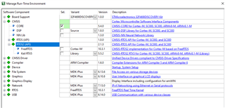

In the CMSIS_v2 documentation I came across a function called osKernelSuspen(). Maybe it is the solution, but I can't use it, because after building the code, I got an error that that function is not defined. But it is in the cmsis_os2.h file, and I changed the #include cmsis_os.h to cmsis2.h.

I have tried to enable FreeRTOS under RTOS2(API) in Manage Run-Time Environment, under CMSIS option, but then the building failed with an error in Heap_Stats. Now only the Core is enabled under the CMSIS option.
Tbh I'm a little bit confused about what should I add or shouldn't, so I use the default settings, and so far I had no problem with it, until now. I have tried Atollic, maybe I have a little bit of luck, but no, the whole IDE was a mess for me.

  • you can take the example project located in your CMSIS:FreeRTOS pack installation folder C:\Keil_pack\ARM\PACK\ARM\CMSIS-FreeRTOS\10.3.0\CMSIS\RTOS2\FreeRTOS\Examples\Blinky as a reference to see how to set up FreeRTOS in Manage Run-Time Environment dialog for your project
