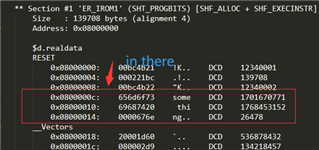

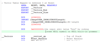

I can use the symbol |Image$$ER_IROM1$$RO$$Length| to write the RO Length in my Image.
IMPORT |Image$$ER_IROM1$$RO$$Length| DCD |Image$$ER_IROM1$$RO$$Length|
NOW, i want to use the 【name of executable】write in my binary Image(like pic2 and pic3) automatically after buiding my project.How to do that?

I want to know how can i get the Text Input <Name of Executable>value "app" in <output> option( attachment image) by Using some built-in variable or some Symbol like |Image$$ER_IROM1$$RO$$Length|.
I want to find a way to automatically update my binary Image(axf) after building my code in .s file(assembler) in my project.
Do you have some solutions?thanks!

In short , I want to code some assemblers in .s file in order to write the Text Input <Name of Executable>value "app"(or other input) in my binary program image, after building my project.
why do you want to do that?
for building USER-MODE application program with project name(project name built in .bin file) in rtos.
Supply it as a command-line define, using the appropriate uVision "Key Sequence"

Andy Neil said:Supply it as a command-line define, using the appropriate uVision "Key Sequence"
Im so sorry.I will try it ,thx!
