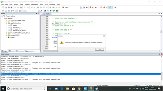

I am trying to start with my STM32F100RBT6B in the STM32VLDiscovery and programming in Keil uVision IDE, with Cube MX. I upload the CubeMX code for the uVision and finished the code with 0 Errors and 0 Warnings, but when i try to Download the code to flash memory it replies with this:
and then the flash download fail.

Andy Neil said:ISTR a thread recently about disappearing support for ancient STLinks ... ?
Found it:
https://community.arm.com/developer/tools-software/tools/f/keil-forum/45556/command-not-supported-during-download-with-keil-mdk-arm-v5-29/162844#162844
