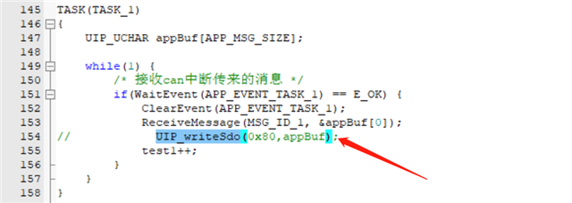

if I add function UIP_writeSdo(0x80,appBuf) in the thread TASK1 , the data in RAM(0x20000000 to 0x200025a0) is ok,
but if I remove the function UIP_writeSddo(0x80,appBuf) in the thread TASK1 as picture indicate, all the data in memory 0x20000000 to
0x200025a0 is corrupted.

just like the picture indicate:
I just declare UIP__UCHAR appBuf[APP_MAG_SIZE] as an local variable in thread, why it cause this problem?

Does MDK assign memory for local data since compile in stack? I know stack is first in last out, is it suitable to pass a local pointer to a function as argument like the following code?
TASK(TASK_1) { UIP_UCHAR appBuf[APP_MSG_SIZE]; while(1) { if(WaitEvent(APP_EVENT_TASK_1) == E_OK) { ClearEvent(APP_EVENT_TASK_1); ReceiveMessage(MSG_ID_1, &appBuf[0]); UIP_writeSdo(0x80,appBuf); test1++; } } }

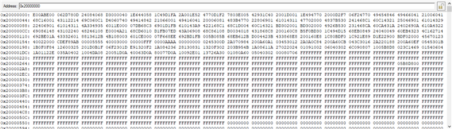

I found that my code cause data in RAM corrupted during startup. I know CORTEX-M3 could copy RW DATA and ZI data from flash to RAM ,it means my code in thread has damage this procedure, I want inquire to how data in flash copy to RAM?
JackShan said:it means my code in thread has damage this procedure
No, it most certainly doesn't mean that, because that procedure has finished long before any code in your thread gets executed. What can happen is if you overflow the stack wildly enough, your code may overwrite any variable of the entire program. Which is why you really have to take care not to do that. Ever.
hello broeker
I operate like the following procedure, open debugger window and then click next step. I found the data has been modified before enter main function. so I suspect my code influnce the procedure that CORTEX-M3 copy data from flash to RAM, I do not know much about that, so I want to inquire you that.
