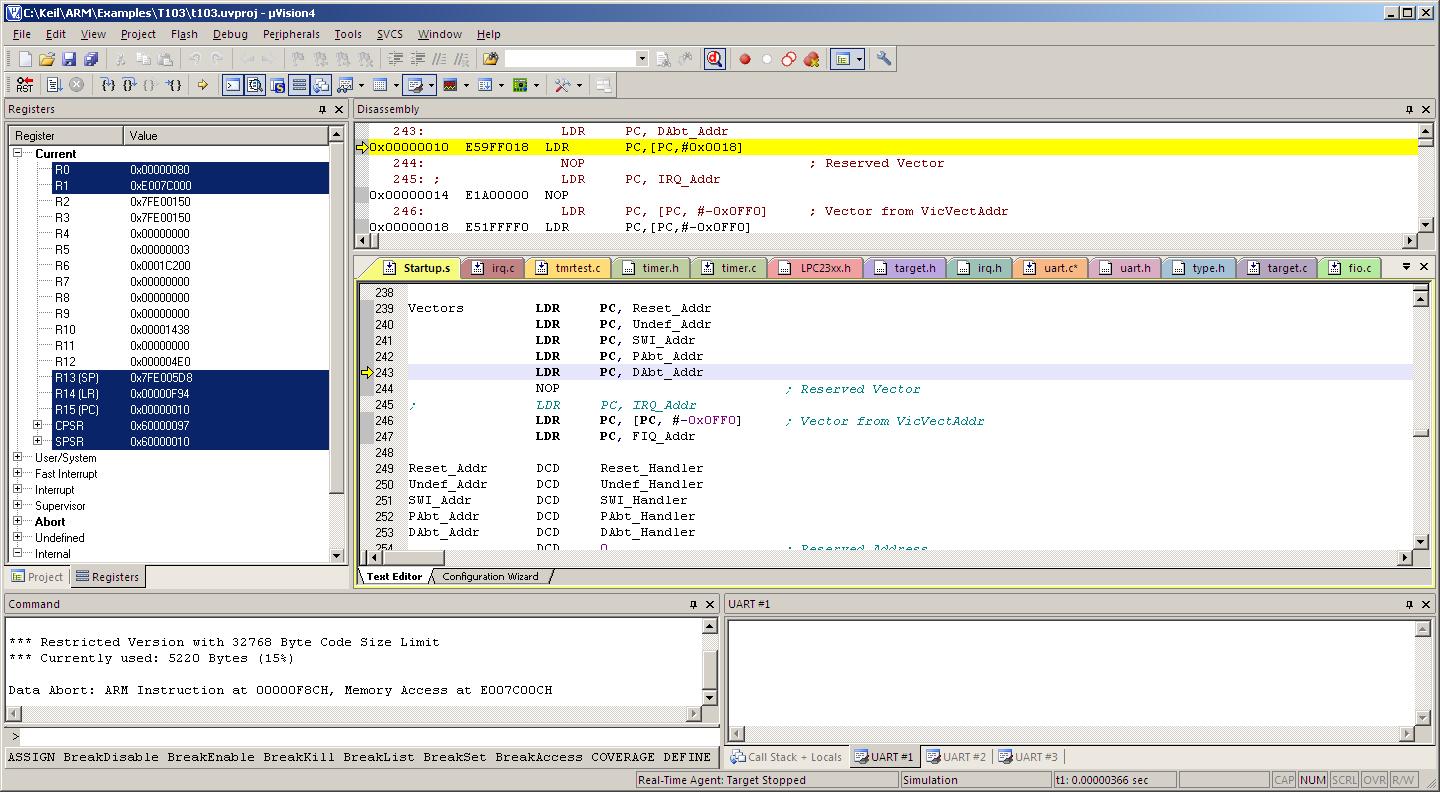

I have a problem about using UART3 on LPC2361
My code is:
PCONP |= (1 << 25); /* Enable PCUART3 */
PINSEL0 |= 0x0000000A; /* P0.0 TXD3, P0.1 RXD3 */
U3LCR = 0x83; /* DLAB = 1, 8 bits, no Parity, 1 Stop bit */
when start the debug session, at U3LCR = 0x83 command I receive:
"Data Abort: ARM Instruction at 00000F8CH, Memory Access at E007C00CH"
You can see the uVision window at this momment here: www.beacom.ro/.../uvision.jpg
I use demo version of uVision from MDK-Lite (32KB) Edition.
