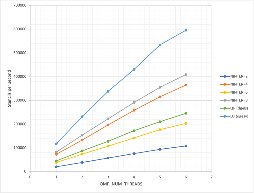

    Here's a plot of the multi-threaded scaling of the outer loop over systems:
