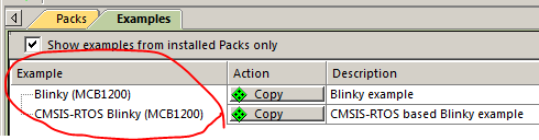

3) The other issue could be the addresses you have set for the LPC1200:
4) Can you load one of the two provided Examples into your board :
