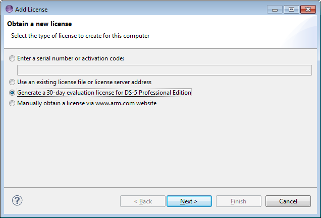

    If you want to evaluate ARM Compiler, you could just generate a 30-day eval license of DS-5 Professional Edition from within your Altera installation by clicking Help > ARM License Manager, Add License > Generate a 30-day evaluation license for DS-5 Professional Edition.

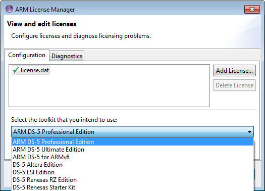

    Then, it's just a case of swapping the toolkit over:
    DS-5 will then need to restart - enabling all the features of Professional Edition.
