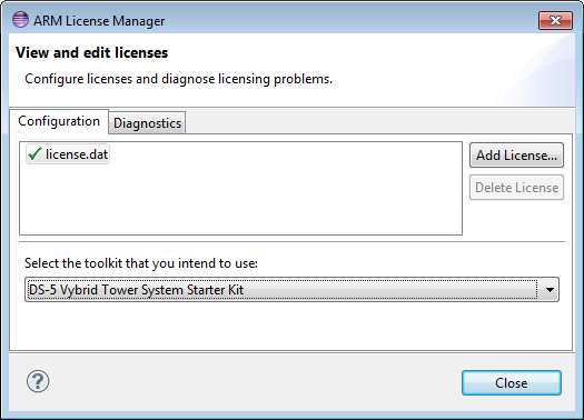

Hi Amarti,
In the ARM License Manager, do you have this toolkit highlighted in the "Select the toolkit that you intend to use" pull down?
Hi Ronan,
yes, this toolkit is highlighted. This is how my License Manager looks like:

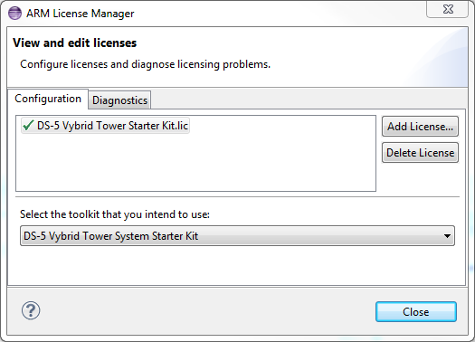

Hmm... in your first message it states:
Yet from the screenshot it appears to be set. I've never seen this occur before
It might be useful to delete the license, restart the GUI, and re-add the license.
If that doesn't work, I would recommend you contact ARM directly at license.support@arm.com
that worked!
I moved the .lic file manually to another directory (could not delete it in License Manager), then re-added it in the License Manager.
