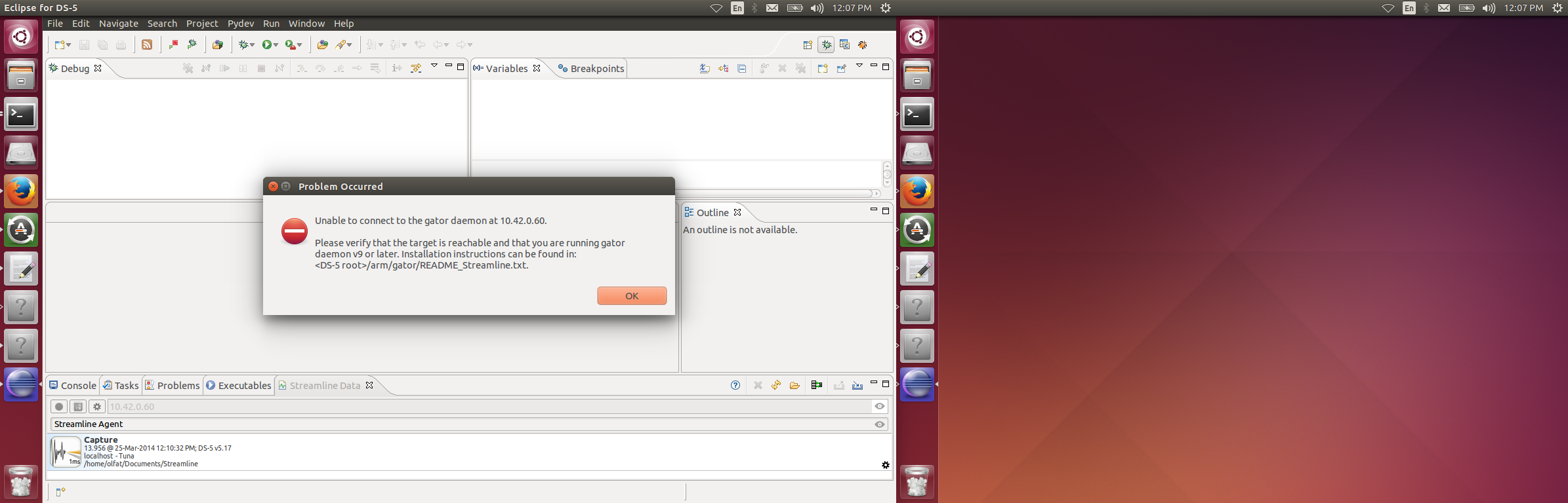

    Than you very much for your guide. i already built my Damon and gator but when i try to use stream line it give me the error on the photo do i need to use any option " something to replace the adb forward command used with android?
    Screenshot from 2014-05-12 12:07:08.png
    Thanks
  • Hi,
    It seems Streamline cannot communicate with the gator daemon running on your target.
    Please check that gator daemon is running in the background, by using the 'ps' command.
    If you are connected to the Android target by USB, then you will have to forward ports and enter 'localhost' in the Address field instead of the IP address.
