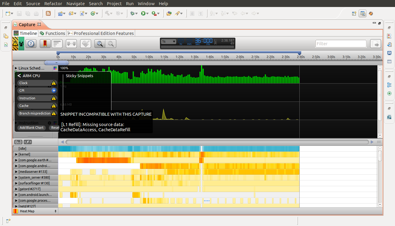

I'm using ARM DS-5 (DS-5 Community Edition) Version: 5.17.1 stream line to analyse my Samsung galaxy Nexus maguro with customize factory img yakju-jwr66y to work with streamline.
when i analyse the data i can not get info about the cache it gives me the error ds-5 streamline cache l1 refill missing source data $Cache Data Refill / $Cache DataAccess
i really need to get the number of hits and missed to the cache in order to now the bandwidth used by each program running into my system so i would appreciate your help.

thought a pic would be useful

You get that error if you did not capture those counters in the trace you are using.
You'll need to add the cache counters to the capture list in the counter configuration window before you start capturing data (there are limits on how many counters you can capture in parallel, so you may need to remove a few to make space).
