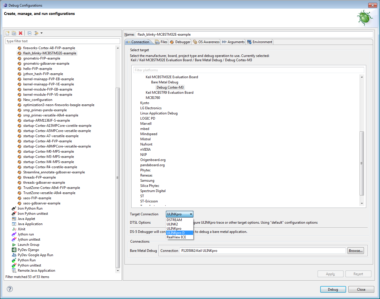

I have one more question. Without any connected probe, the popup menu in the debugger connection page displays only DSTREAM and RealView, and no ULINKpro. Is it a choice that appears only if a ULINK pro probe is actually connected to a USB slot? Or could it show that something is wrong in my DS5 installation (btw I did run the post-installer script)? I dont currently have a ULINKpro probe (I'll try to get one asap), so I have to rely on someone else's experimentations.
Since ULINKpro D is a new product, there are not as many pre-built debug configurations in DS-5 as there are for DSTREAM. The list of platforms that are currently supported can be found here: http://ds.arm.com/supported-devices/
In the Debug Configuration menu in DS-5, ULINKpro D should be listed if it is supported (for instance in the screenshot below), they appear regardless of USB connection, though you need to browse for a connection when actually connecting to a target board. There is probably nothing wrong with your installation.
