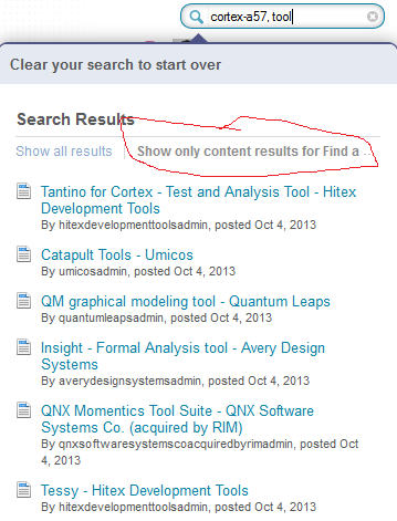

You could also search the Find a Partner directory. Ways to Search or Filter Company or Products describes the various ways to search. Or you can use the general search bar. Here I did "Cortex-a57 and tool" and then selected "show only content results for Find a Partner at the top". There are more results than shown here.
Happy searching!
