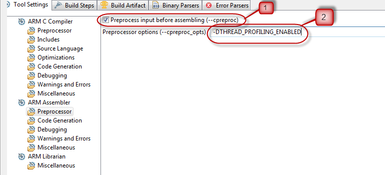

I am interested to use C pre-processor in assembly file but i am facing the attached issue. According to arm documentation
I set the flag --cpreproc and --cpreproc_opts but getting following issue:

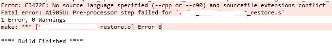

Error: C3472E: No source language specified (--cpp or --c90) and sourcefile extensions conflict
Fatal error: A1905U: Pre-processor step failed for '../xx_xxxxxx_xxxxx_restore.s'
1 Error, 0 Warnings
make: *** [xx_xxxxxx_xxxxx_restore.o] Error 8

    armasm --cpreproc --cpreproc_opts='-DTHREAD_PROFILING_ENABLED' --cpu=7-R --arm -g -o "xx_xxxxxx_xxxxx_restore.o" "../xx_xxxxxx_xxxxx_restore.s"
    Fatal error: A1905U: Pre-processor step failed for '../tx_thread_context_restore.s'
    1 Error, 0 Warnings
    make: *** [tx_thread_context_restore.o] Error 8
    **** Build Finished ****
