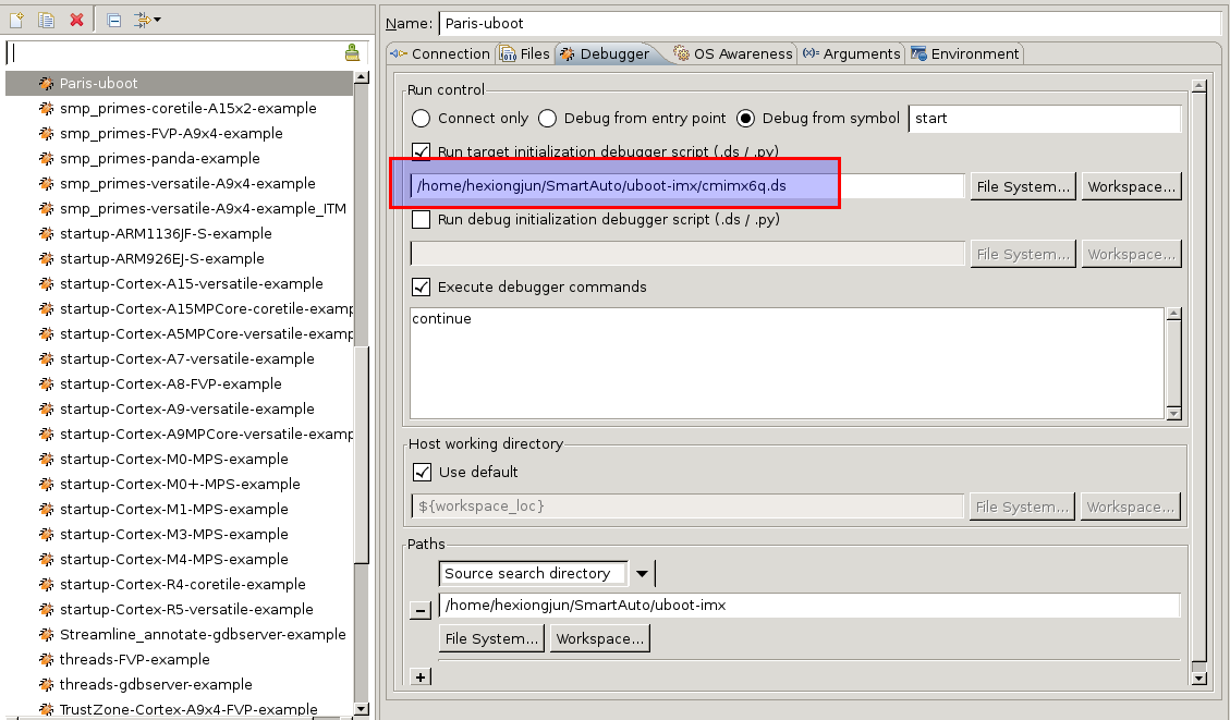

I want to use the DS-5 and DStream to debug the u-boot, so I write a memory initialization sequence into file cmimx6q.ds, which is a list of commands like:
mem set 0x020e05a8 32 0x00000028
and I specify this file as the input of Run target initialization debugger script from Debugger tab in Debug configuration Option . The attach png shows it.
