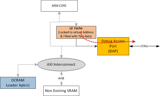

    Based on the following figure from ARM CoreSight Technical Introduction document( ARM-EPM-039795), We thought DAP  can get data from L2 cache through AXI interconnect / L2 cache controller but not through ARM Core.
    From the above figure we infered when DAP try to read a memory location(non existent) whose data avail in L2 cache  with state as "Modifed",the AXI interconnect/L2 cache controller detects the latest data is in L2 cache and will provide the latest data in cache through AXI interconnect as response to the read.
    We can read the L2 cache values through JTAG (using xsdb console). We know this much as we got the proper values that was written by the application program.

    1.For the read access from DAP data in L2 cache was returned by AXI interconnect/L2 controller as explained above.
    2.For write transaction from DAP, the AXI interconnect/ L2 controller detects it as a write to an address which is available in L2 cache with status as "Modified". Since AXI interconnect cannot write to the L2 cache(even though it can read),it will permit the write transaction to the physical address. Now L2 cache controller takes it as content modification in memory and it will change the status of this address in L2 cache as "invalid". This status is applicable to the cache line.
    3.For Further reads from DAP, to the above address, AXI interconnect/ L2 controller detects it as read from an address in L2 cache with status as "invalid" and so instead of giving response from L2 cache, it wil allow to read from the "non-existent" physical address space and so we get junk data (in this case we saw all 0s).

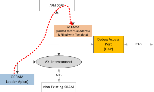

    4. Further, when we tried to read from the same location from application in OCRAM (through ARM core), we got 0s for that cache line. This could be because, when core tried to read from the address, it found status in L2 as "invalid" and so tried to fill cache line from the "non-existent" SRAM and so cache line became 0000.
    As you mentioned, if we can write to L2 cache from DAP through ARM core, we would like to know how to do that. As described above, for our attempt, we don't think it happened through the ARM core.  If there is a way to do that, that would solve our problem.
