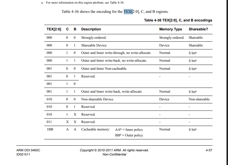

In ARM cortex R5, what is the behaviour when TEX = 001 and C =1, B=0 and S=0 ?
In the documentation, this particular entry in the table is kept empty.
Also can you please explain how bufferable property impacts reads ? FYI I am trying configure MPU regions on memory mapped external flash. Please do let me know if you have recommendations for the same.
