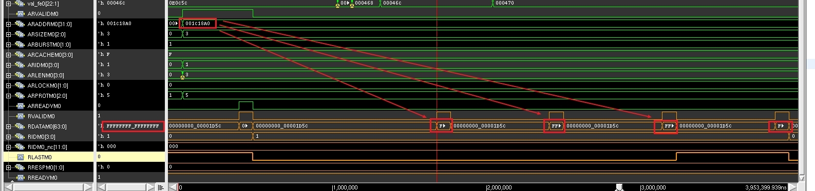

Hi *,
We meet a problem about R5F core, it fetch instruction from an unexpected  reserved address, as shown in the figure below, The correct order of instruction fetching should be 0x860 -> 0x880 -> 0x89B -> 0x8c8, But what actually happens is  0x860 -> 0x880 -> 0x89B -> 0x001c18a0 -> 0x8c8. The address 0x001c18a0  is reserved, i.e the disassembled code generated by the software shows that address 0x001C18A0 is never referenced or used, either as a target address or as a location for stored data(kindly refer to the attached file example.s ).
And the ARPROTM0[2:0] = 5 shows the read 0x001c18a0  is a fetch instruction action.
By the way, the RDATAM0 of read from 0x001C18A0 is 0xFFFFFFFF_FFFFFFFF, this suggests that the processor core should transition into the illegal instruction exception handler. But in fact, the core did not enter the exception handler and instead continued executing normally.
We would like to ask two questions:
1. Why does the core unexpectedly access address 0x001C18A0? Is it doing prefetch?
2. If it is prefetch, is there a way to disable this prefetch behavior in the core? Because the unexpected access to the reserved address causes errors in the system's error monitoring module.
