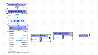

I have a very simple CortexM3 based virtual platform example as below
The amba_pv_m2 is connected to a memory in the top. The BusDecoder master port address range is 0x0-0x3FFFFFFF
I have the following C program

Bow I want to load the SW at 0x40000000. For that I did the following chnages
- BusDecoder master port address range 0x40000000-0x7FFFFFFF and make command as
armcc --cpu=Cortex-M3 -g -O2 -c -o hello.o hello.c
armlink --cpu=Cortex-M3 --ro-base 0x40000000  -o hello.axf hello.o
with that the when I run the platform, it stucks somewhere and I am not getting the Hello output.

  • A few things to add:
    Cortex-M3's initial vector table address is fixed at address 0x00000000. (This is different in Cortex-M7/M23/M33, which allows the initial vector table address to be configured by chip designers.
    Startup code usually contain vector tables as well as some startup related code.
    Example startup code for Cortex-M3 can be found in CMSIS github
    https://github.com/ARM-software/CMSIS_5/tree/develop/Device/ARM/ARMCM3/Source
    As Vanhealsing mentioned, the architecture used by Cortex-M processors has a predefined memory map, and address 0x40000000 is predefined as peripheral region and cannot be used for program code storage (same restriction for Device and system spaces).  The predefined memory map simplifies startup as you don't need to configure which region to be cacheable.
    regards,
    Joseph
