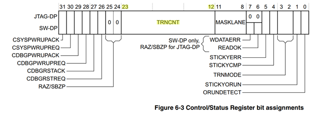

I have a question regarding the TRNCNT field in the DP CTRL/STAT register in the ARM Debug Interface v5 Architecture Specification.
In Figure 6-3 (Control/Status Register bit assignments), TRNCNT is shown as [23:12]. The Transaction Counter section also explicitly states that the TRNCNT field is [23:12].

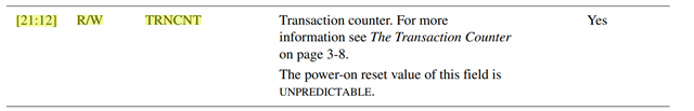

However, the CTRL/STAT register table lists TRNCNT as [21:12].
Could you please confirm which bit range is correct for TRNCNT: [23:12] or [21:12]?
