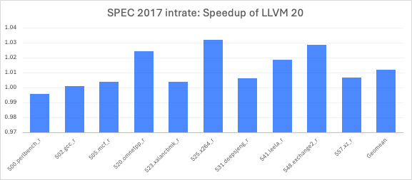

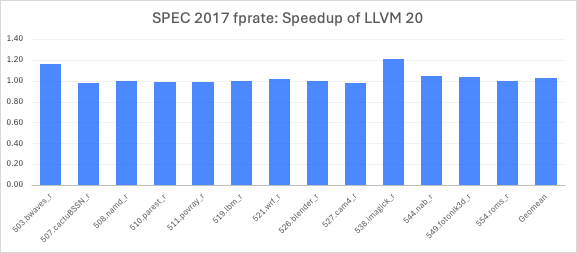

A set of LLVM transformations developed by our team has delivered significant performance improvements across multiple SPEC2017 benchmarks.
Canonicalizing getelementptr (GEP) instructions with constant base pointers and offsets improved performance by over 3% in the 548.exchange2_r benchmark by enabling better constant folding and shared offset computation. Enhancements to the Superword Level Parallelism (SLP) vectorizer, particularly in load instruction ordering and clustering, yielded a 3% improvement in 525.x264_r.
Loop-Invariant Code Motion (LICM) was improved by teaching Clang to emit nuw (no unsigned wrap) GEPs and enhancing BasicAA to leverage them for alias analysis, enabling better hoisting/sinking of struct field updates and delivering a 0.89% gain in 557.xz_r. Function specialization for constants passed by reference, commonly seen in Flang code, significantly boosted performance in the 503.bwaves_r benchmark. Additionally, the AArch64 backend was optimized to avoid generating expensive ld4 instructions for uitofp(ld4) patterns, preferring more efficient and/shift operations, resulting in a 22% gain in 538.imagick_r.
Overall, these and other community-driven improvements led to a 3% uplift in SPEC2017 floating-point rate (fprate) and a 1% gain in integer rate (intrate) on Graviton 4.
