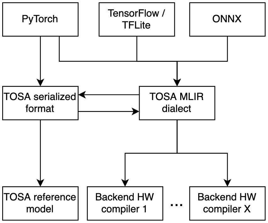

Tensor Operator Set Architecture (TOSA) provides a set of whole-tensor operations commonly employed by Deep Neural Networks. The goal is to enable a variety of implementations running on a diverse range of processors, while ensuring consistent results at the TOSA level. Applications or frameworks which target TOSA can be deployed on a wide range of different processors. These include SIMD CPUs, GPUs and custom hardware such as NPUs/TPUs, with defined accuracy and compatibility constraints.
Arm recently released the TOSA 1.0 specification and supporting software, including an MLIR dialect, a serialization format, and a reference implementation. This release marks an important milestone. It is the first release to enforce backwards compatibility guarantees between minor versions of the specification and software. This means TOSA artifacts produced in this version of the software must continue to work between minor versions of TOSA.
TOSA software overview:
 TOSA software architecture
LLVM 21 is the first release that supports the TOSA MLIR dialect aligned with version 1.0 of the TOSA specification.
