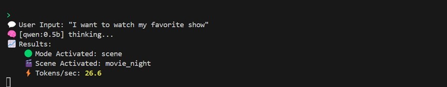

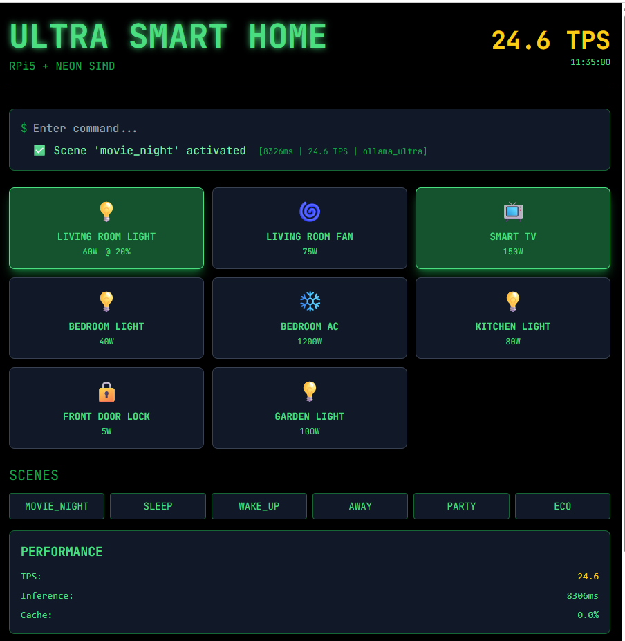

UI when running Qwen
Figure 1: UI when running Qwen.

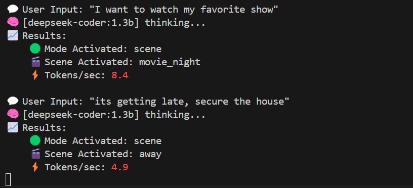

UI when running DeepSeek
Figure 2: UI when running DeepSeek.

Qwen
DeepSeek
Gemma2
  • Ollama LLM Backend: All Natural Language Processing (NLP) runs on-device using Ollama, supporting models like Deepseek, Tinyllama, Qwen, and Gemma. Models are pulled and run locally, requiring no external API.

  • Direct Device Control: Supports GPIO, MQTT, and Zigbee for direct hardware integration with lights, fans, plugs, sensors, and more.

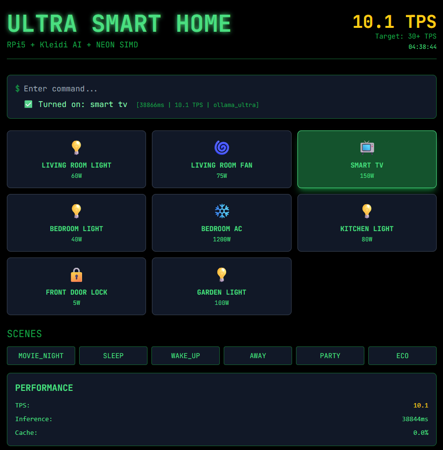

  • Web Dashboard & API: Includes a clean UI and REST API for control and monitoring, plus a Command Line Interface (CLI) for advanced users.
  • Real-Time Metrics: Monitors LLM speed (tokens/sec), command latency, power consumption, and cache hits—ensuring full transparency and performance tuning.

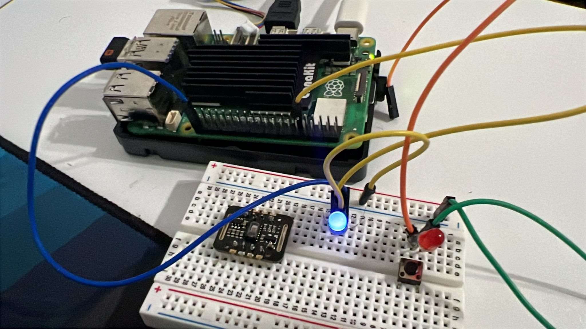

Hardware setup
Hardware setup
Figure 3: Hardware setup
  • Raspberry Pi 5 (8GB or 16GB recommended). This single-board computer features a quad-core Arm Cortex-A76 CPU, each core operating at up to 2.4 GHz. The Arm cores support NEON SIMD (Single Instruction, Multiple Data) extensions, enabling efficient parallel processing for optimized performance in compute-intensive applications.
  • Raspberry Pi OS 64-bit (or Ubuntu 22.04 ARM64).
  • MicroSD or NVMe Storage.
  • Internet for initial setup (operates offline once deployed).
  • GPIO devices: lights, sensors, etc. connected via GPIO/MQTT/Zigbee.

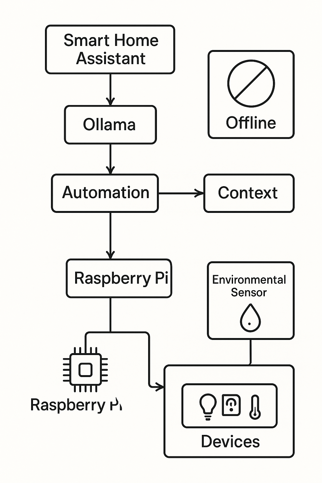

System architecture
The system employs a fully local workflow from command to action.
System architecture
Figure 4: System architecture

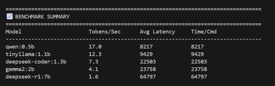

Benchmark summary
Figure 6: benchmark summary

Performance metrics
Metric
Local LLM on Pi 5 (Ollama)
Cloud-Based AI
Notes
Inference Latency
~1–9 sec (Tinyllama 1.1B)
0.5–2.5 sec (+network jitter)
Local is consistent, private, and predictable.

Tokens/Second
8–20 tokens/sec
20–80+
Local models are rapidly improving in speed on Arm hardware.
