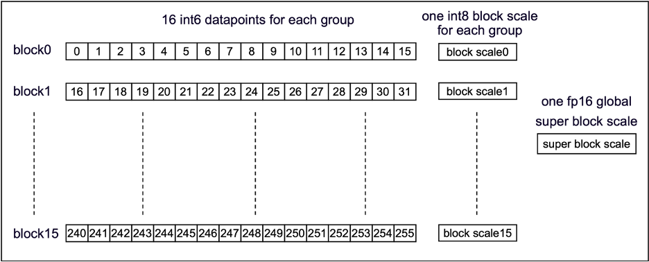

Q6_K is more complicated. As shown in the picture below, datapoints are organized in two levels:
  • One super block of 256 datapoints. One super block scale factor in floating point format.
  • Each super block consists of 16 blocks. There are 16 datapoints in each block, which share one block level scale factor in integer format.
 Llama.cpp Q6_K quantization
Figure1: Llama.cpp Q6_K quantization

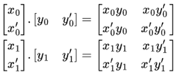

Following the textbook approach, we can calculate the four scalars in the output matrix one by one. That is, the first output scalar is the inner product of the first row of matrix x with the first column of matrix y. Four inner product operations are required.
There’s a more efficient way to do it with outer product. As shown in the following figure, we can instead multiply the first column of matrix x with the first row of matrix y to get the four partial output scalars in one shot. Sum the two partial outputs lead to the result. Only two outer product operations are necessary.
Figure 3: outer product

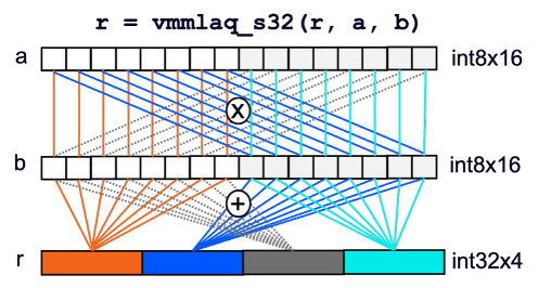

smmla implements vector level outer product, as the picture below shows. Please note vmmlaq_s32 is the compiler intrinsic implements smmla instruction.
  • Each input vector (int8x16) is divided into two int8x8 vectors
  • Calculate inner product of the four int8x8 vector pairs
  • Store results to the four lanes in the output vector (int32x4)
 smmla instruction
Figure 4: smmla instruction

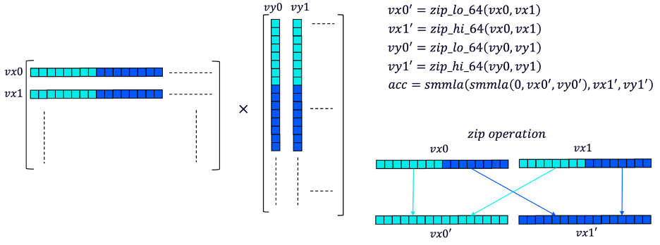

Armed with smmla instruction, we can accelerate matrix multiplication by progressing in two rows and two columns. As explained in the following figure, the computation steps are:
  • Load two rows (int8x16) from matrix x to vx0 and vx1, two columns from y to vy0 and vy1.
  • Zip vx0, vx1 to combine bottom halves of the two vectors to one vector, and upper halves to another one. This is necessary for smmla to work correctly. Same for vy0, vy1.
  • Calculate four temporary scalar results with two smmla instructions.
  • Progress to next blocks and accumulate temporary results until all data is consumed
 matrix multiplication with smmla
Figure 5: matrix multiplication with smmla

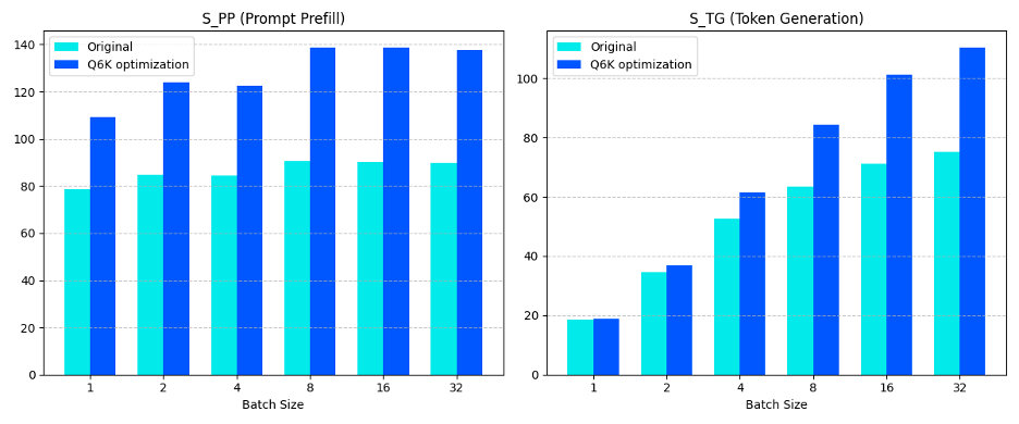

We optimized Llama.cpp Q6_K and Q4_K matrix multiplication kernels with smmla and observed big performance uplift. Picture below compares Llama.cpp performance before and after Q6_K optimization:
  • S_TG: speed of token generation, higher the better
  • S_PP: speed of prompt prefills, higher the better
The test platform is Arm Neoverse-N2.
 Arm I8MM improves Llama.cpp Q6_K model performance
Figure 6: Arm I8MM improves Llama.cpp Q6_K model performance
