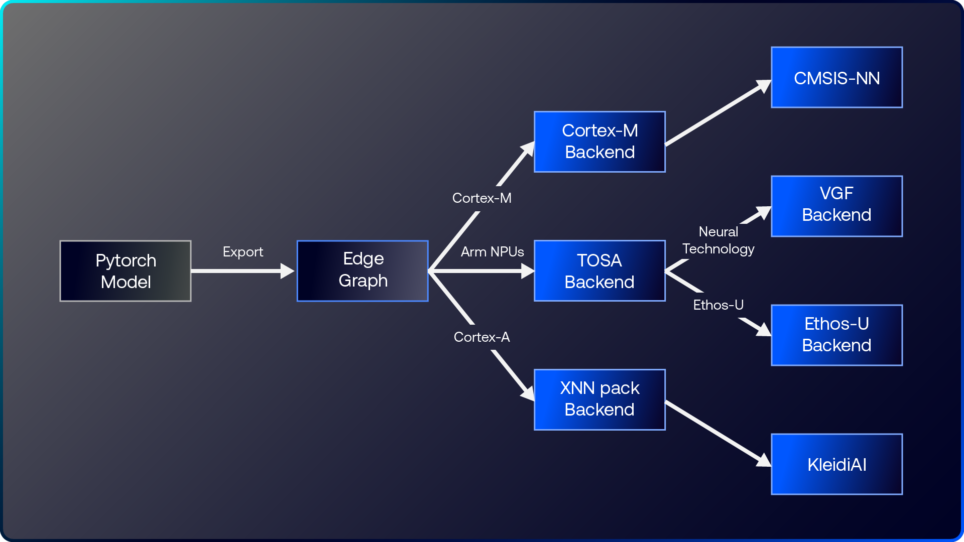

From PyTorch to the edge: The whole flow
ExecuTorch streamlines the journey from PyTorch models to efficient embedded execution. As shown in the diagram below, models can be exported and lowered through different backend delegates that map onto the full spectrum of Arm edge IPs, from NPUs to Cortex-A and Cortex-M CPUs. This unified stack means developers can begin in PyTorch and seamlessly deploy across diverse Arm-based edge devices with consistent tooling, predictable performance, and a clear path from research to production.
Diagram showing how Arm's edge IPs are supported via ExecuTorch backend delegation.
Figure 1. How Arm's edge IPs are supported via ExecuTorch backend delegation.

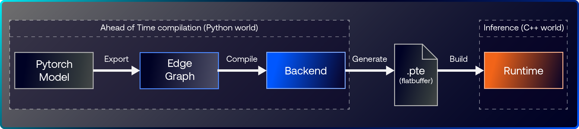

Python-native backends: Hackable and extensible
One of the strengths of the Arm integration in ExecuTorch 1.0 is that the entire flow – from model lowering down to the backend compiler – is implemented in Python. This makes the backends transparent and hackable:
  • Developers can easily inspect and modify the lowering path.
  • Missing functionality can be added without diving into opaque C++ or proprietary toolchains.
  • Contributions back to the project are straightforward, empowering the community to expand operator support and optimize performance.
This design choice keeps the developer experience close to PyTorch, while still unlocking the efficiency of Arm hardware. It means that if you need to adapt ExecuTorch for your own model, workflow, or hardware configuration, the tools are right there at your fingertips.
For deployment, ExecuTorch provides a lightweight C++ runtime that is easy to integrate into any application. The runtime is designed for portability and efficiency, delivering predictable performance on resource-constrained devices while keeping the deployment footprint small. Together, the Python development flow and the C++ runtime create a seamless bridge from experimentation to production.
Diagram showing that ExecuTorch has an efficient C++ based runtime and a hackable AoT comilation flow.
Figure 2. ExecuTorch has an efficient C++-based runtime and a hackable AoT compilation flow.
