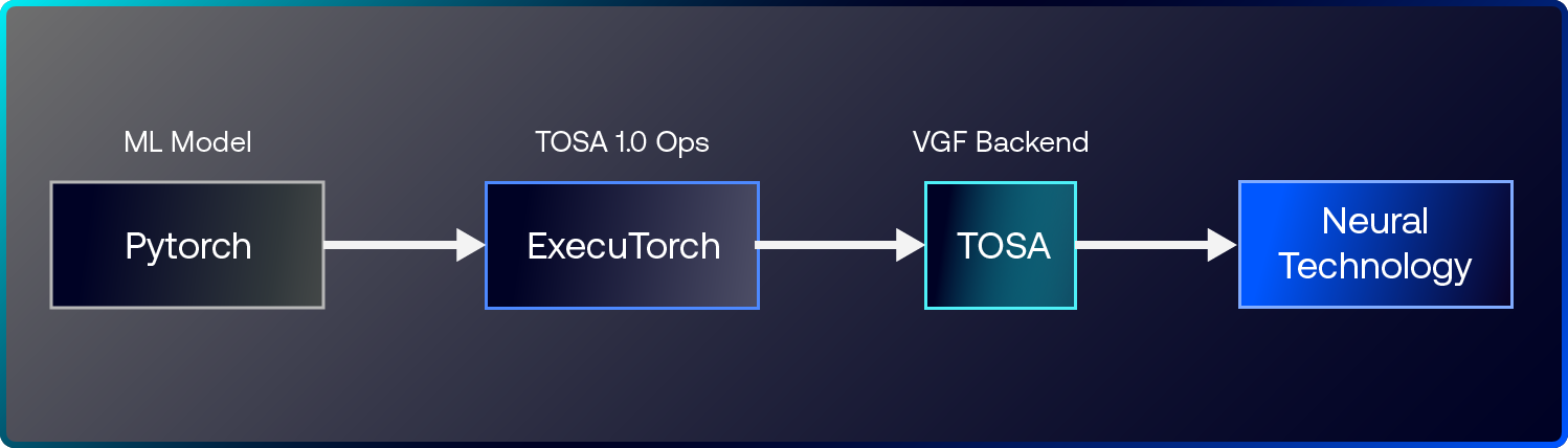

Diagram showing Neural Technology Flow
What makes this new support possible is the VGF backend. It introduces an ahead-of-time compilation flow and runtime integration that bridge the gap between PyTorch models and efficient deployment on neural technology capable hardware. The backend provides tooling to export models as portable files and to run them through the ExecuTorch runtime and execute them on a VGF emulator. This makes it possible to develop networks on a standard ML development platform and target any hardware with future Arm GPUs.
