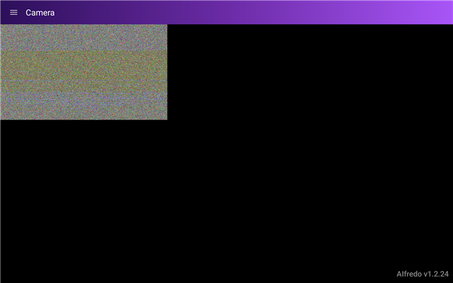

On-device GPU compositing + Vulkan WSI present path is unusable on the affected device. Apps that
present from a compute queue (matting, ML inference, custom GPU UI) have no path to use a
VkSwapchainKHR — must fall back to ANativeWindow_lock + memcpy or implement an EGL/GLES bridge
workaround.
[Workaround implemented for reference]
EGL/GLES bridge present path using AHardwareBuffer + eglSwapBuffers,
replacing VkSwapchainKHR + vkQueuePresentKHR entirely. The Mali GL ES
driver path uses a separate (mature) sync subsystem inside the same
vendor library and does NOT crash on the same hardware.
Verified on Tab S11 Mali-G925: 60+ seconds of continuous RTSP feed
rendering, no SIGSEGV in libGLES_mali.so. Same APK that crashed
within 0-6 frames using vkWaitForFences / vkWaitSemaphores /
vkGetSemaphoreCounterValue / vkQueueWaitIdle.

=== Mali-G925 SIGSEGV — variant 1 — vkWaitForFences ===
Device   : Samsung Galaxy Tab S11 (SM-X736B)
Build    : samsung/gts11eea/gts11:16/BP4A.251205.006/X736BXXU5AZBC_OXM5AZBC:userdebug
Kernel   : 6.6.102-android15-8-abogkiX736BXXU5AZBC-4k
GPU      : Mali-G925-Immortalis MC12
Driver   : 49.1.0
Vulkan   : 1.3.278
App      : com.samsung.aifredo.debug
Source   : vulkan_swapchain.cpp using VkFence per-CPU-slot recycle pattern
Build ID : varies per APK rebuild

Time to crash : 0-6 frames after first vkQueueSubmit on the swapchain
                command buffer.
Reproducibility: 100% with default swapchain pattern (FIFO, 4-5 images,
                 per-frame fence recycle across kFramesInFlight=2).
