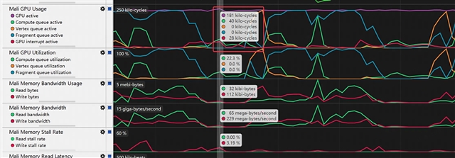

I have a compute shader for landscape patch culling running before basepass in UE4, but in streamline i found compute shader running 40kilo-cycles but "gpu active" is 181kilo-cycles. Where is the remain cycle(181 - 40  - 28 = 113kilo-cycles) running?

  • Where is the remain cycle(181 - 40  - 28 = 113kilo-cycles) running?
    Any difference will be time spent in the GPU front-end handling scheduling. Scheduling overhead tends to be caused by:
    * High density of small workloads (e.g. many small compute kernels).
    * High densities of pipeline barriers (e.g. many separate pipeline barriers between workloads).
    * High numbers of workloads that trigger L2 cache flushes.

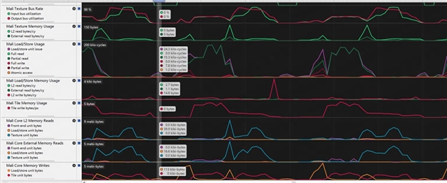

    Below is my compute shader, I use offline compiler it say shader is bound by LD/ST, But "Mali Load/Store Usage" is 24.3kilo-cycles.
    Offline compiler can only analyze the shader code, which your last graph shows does indeed show that load/store has the highest usage. The offline compiler obviously knows nothing about the surrounding use of the API that can cause other inefficiencies.
