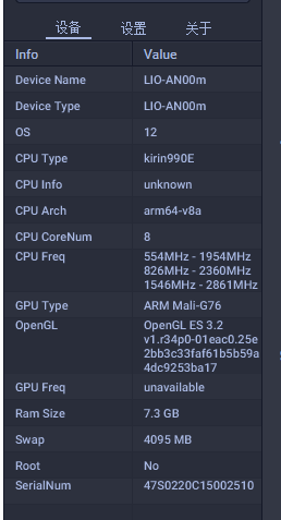

Which GPU and driver version are you using?

hi,this is a overview

There is no valid API reason why a buffer should shrink below its original allocation size, so it sounds like a driver bug. I'm following up with the driver team to see if they have any ideas.
