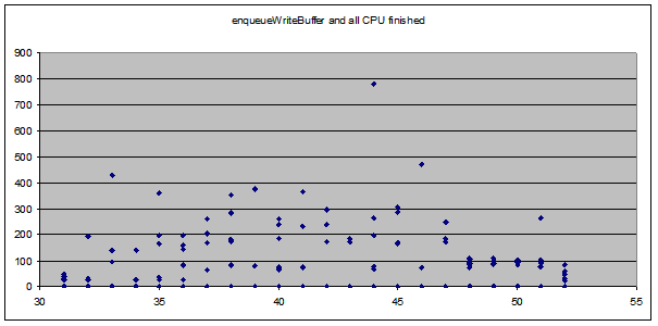

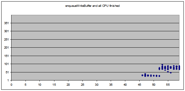

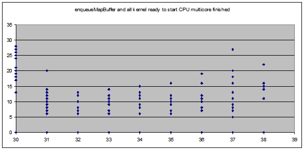

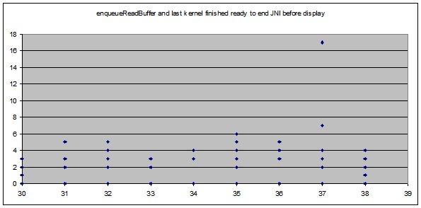

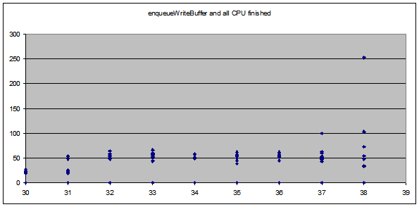

    i have removed the streamline picture. Because too big. But this morning i woke up very early with a new idéa to how to explain what appends in détail. That wake me up ;))
    I will show you 3 picture, that représent the all proccessing  secnde per seconde for each step of the all processing.
    fir all the picture, abscissa information are time in seconde and in ordonate is the duration of the step for every frame processed. It appends that some time for some reason the debug forgot one step or two during CPU processing.
    By the way i can send you more détailled informations but for 21 seconde of analyse it is 500 line of data for 218 frame. quite a lot.

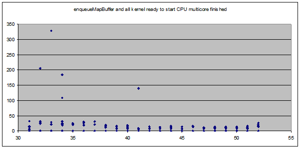

    First picture. I do the first steep of kernel. YUV convertion and some other kernel and enqueueMapBuffer to make available the data for CPU processing.
    As you can see procees time is very stable in time.
    Now, the second picture. In this step where a do all the multicore processing (5 time 4 pthread)
    and (form 1 to 12 time (small amount of data) (2 time 4 pthread) and (1 time 2 pthread)) and some other work in single
    process for drawing pixel for output.i work with a struc of int (1024*1024). i could use Array ?
    Time processing dépending of the amount of data to be processed. But in all the picture i procees
    nearly the same amount of data.I look at the same picture with the camera at the same distance.
    As you can see Multicore processing is completly choatique. And it is for this step that some
    time the debug start missinf frame.
    here is an example of missing frame. look at the NB frame at seconde 32. so one seconde after the app start.

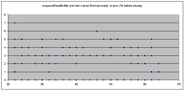

    and the last picture were i do 2 kernel and an enqueueReadBuffer before getting out of JNI for drawing.
    as you can see it is quite stable, between 2 and 5ms. The zéro in every picture are just ecxel blanc value.
    May be the Debug ;))

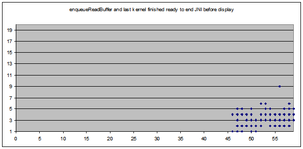

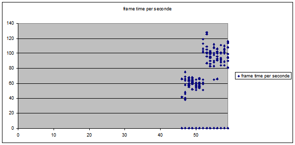

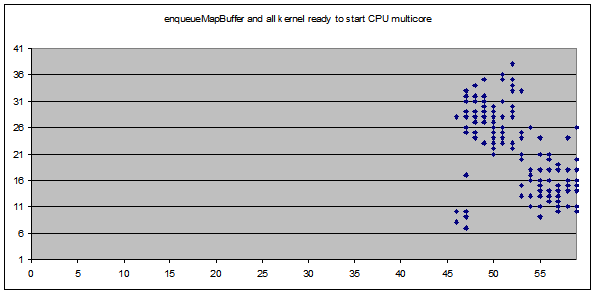

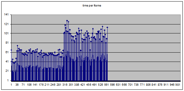

    here are the same 3 picture but this time a removed nearly all the debug and specially the one that inside
    the function called by pthread.
    So i found the solution just because i did this post. At the end i ask myself and if it was just the debug.
    And it was.
    So very sorry. I feel very stupid rigth now. un peu la honte ;))
    have a good day.

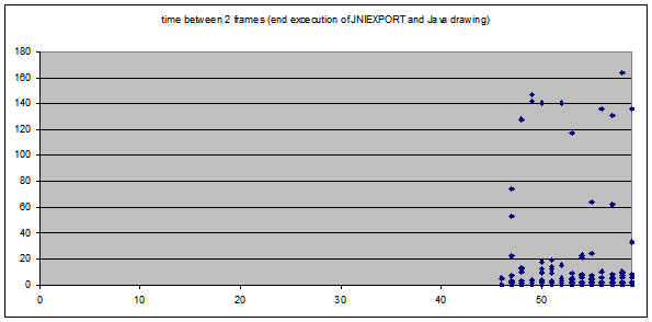

  • hi,
    I made an error in the prévious post. The problem is not solved by removing all the debug. That just inprove the performance. and the picture are wrong because i forgot to modified the abscissa value to the correct time. Both are strating at 30. But i have seen it after posting. Little mistake.
    here are the correct picture without debug. And after more than 50 test it is alway the same. Dépending on the amount of data, after fews seconde there is a drop in time.
    the comment are in the picture like before.
    my conclusion is that  when step 1 (picture 1) slow down. The inpact is a time augmentation in step 2 (picture 2).
    And this is completly strange because if step 1 goes faster step2 should go faster also. But it is the inverse. ?
    I will look at step 1 in more detai to the next post.
  • I suspect the problem is that your algorithm switches between the CPU and the GPU without pipelining them, so both the CPU and GPU are going idle while the other processor is busy. The idle time on a processor often causes frequency scaling control logic to decide that the processor is clocked too high, and so clock frequency gets reduced.
