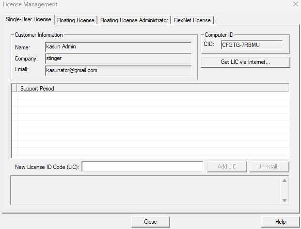

After installation I tried to follow the instructions in the first link above, by going yo uVisons's File > License Management does not have a "User-Based License" tab visible.
Am I doing something wrong ?

this is how it looks like
As Hans mentioned on your other thread (please don't open multiple threads...), we have not seen this before. Very strange...
A possible workaround may be to launch the license utility directly, from //<install_dir>/UV4/armlm/armlm-gui.exe
