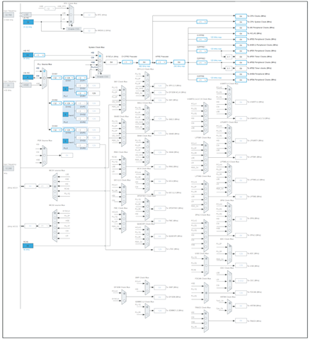

I than generated a very minimalistic Cube-Project to count a value and to trace it and generated a uVison-Project from it. I somehow made it work to trace it in Ozone, as far as I remember correctly I used the pex-File for it. But unfortunately, I don’t know what I did wrong, the tracing does not capture any data any longer.
I also tried the same with uVision on that project. I always get the error, that no trace frequency arrives. I set it exactly as read from the Screenshot of the Cube Project, but no matter what I tried, I don’t get tracing frequency, despite that the currently used 64 MHz should be easily captured by a J-Trace PRO.
